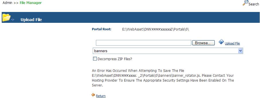

First, in site Admin>> Event Viewer, I clicked Clear Log.  Next, using Admin>>File Manager, I uploaded the js file and it was successful.   Then, I tried to upload the same js file and it displayed the error:
An Error Has Occurred When Attempting To Save The File E:\WebAsset\_______\Portals\0\banners\banner_rotator.js. Please Contact Your Hosting Provider To Ensure The Appropriate Security Settings Have Been Enabled On The Server.  (see attached screen print)
I then checked Admin>> Event Viewer and it’s still empty.  I logged into the server, went into Administrative Tools>Event Viewer.  There were no warnings nor errors logged in the Application or System view at the time I got the upload error.
